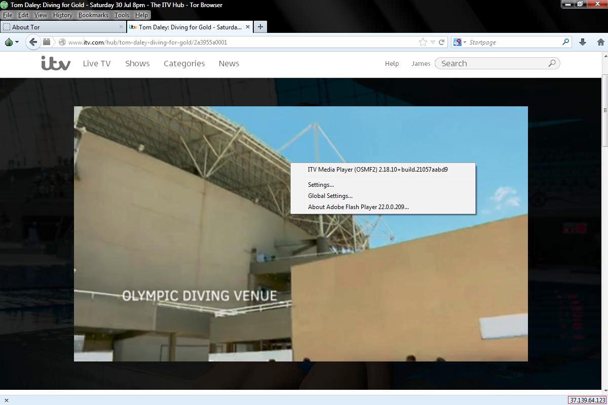

I already had a (bogus) account with ITV, so I then began
my own tests: Let me just say that they don't blacklist
all UK exit nodes in a blanket fashion
The very first time I tried, my GB exit node was "163.172.211.135";
that specific one was BL, hence see attachment "TorBrowserITVFailure.jpg"
Once I exited and then relaunched, I got me another GB exit node,
"37.130.227.133", that was WL! The video in question started to play,
see attachment "TorBrowserITVSuccess.jpg"
On another later relaunch of the Tor Browser I was again lucky
with exit node "37.139.64.123", see attachment "TorBrowserITVSuccess2.jpg"

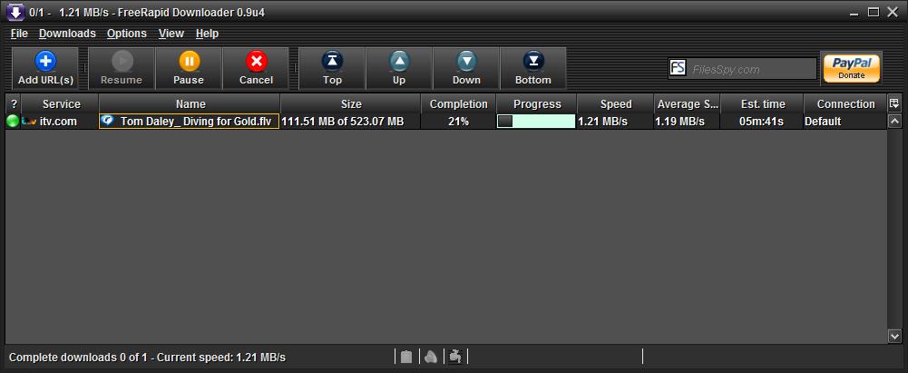

Having my hopes rekindled after the Tor Browser results,
I went back to FRD: After a nerve-wracking situation of maybe more
than ten consecutive cycles of "Cancel & Resume", I was finally able
to initiate the ITVhub download, see attachment "FRD_ITV_Success.jpg"
So it is plausible that, after many repeated attempts,
you'll get a WL GB Tor exit node and hence succeed!
